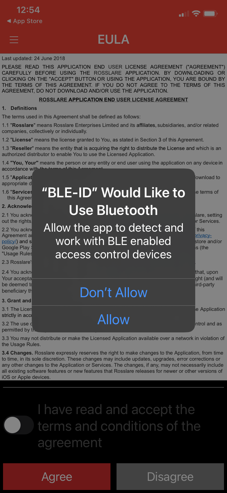

2. Open the App and tap on [Allow] BLE ID to use Bluetooth
Allow BLE ID to Use Bluetooth

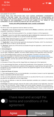

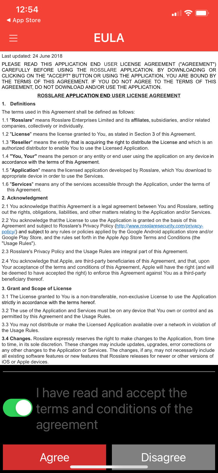

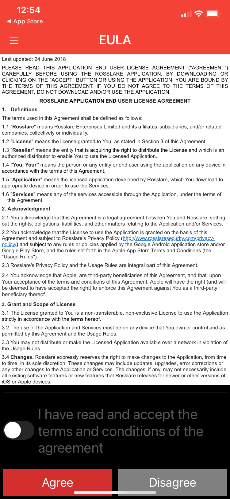

3. Tap on the "I have read and accept the terms and conditions of the agreement
Terms and conditions
Agreed to Terms and Conditions
4. Click on the [Agree] Button to Continue

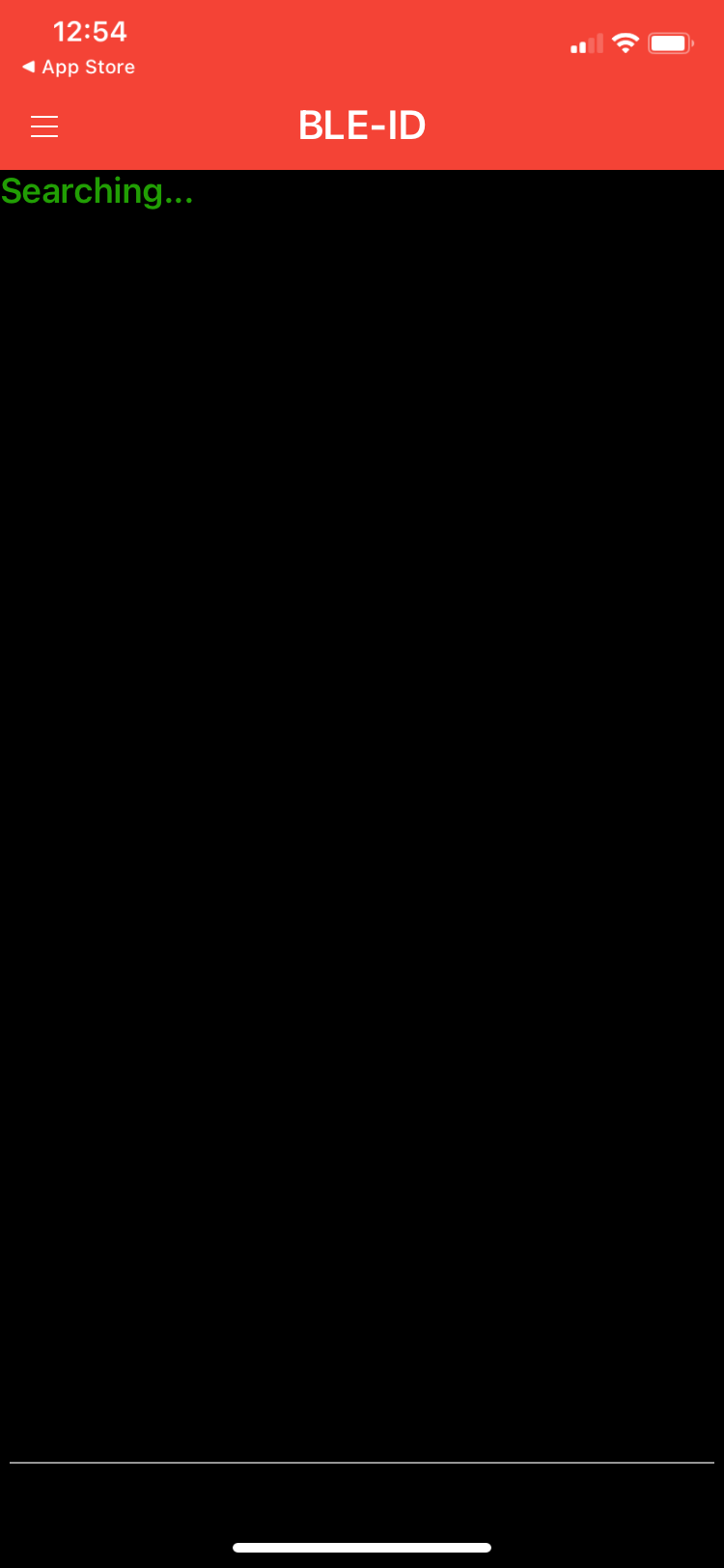

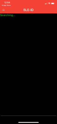

5. The BLE ID App will then begin to scan for any available door readers
Scanning for Door Readers

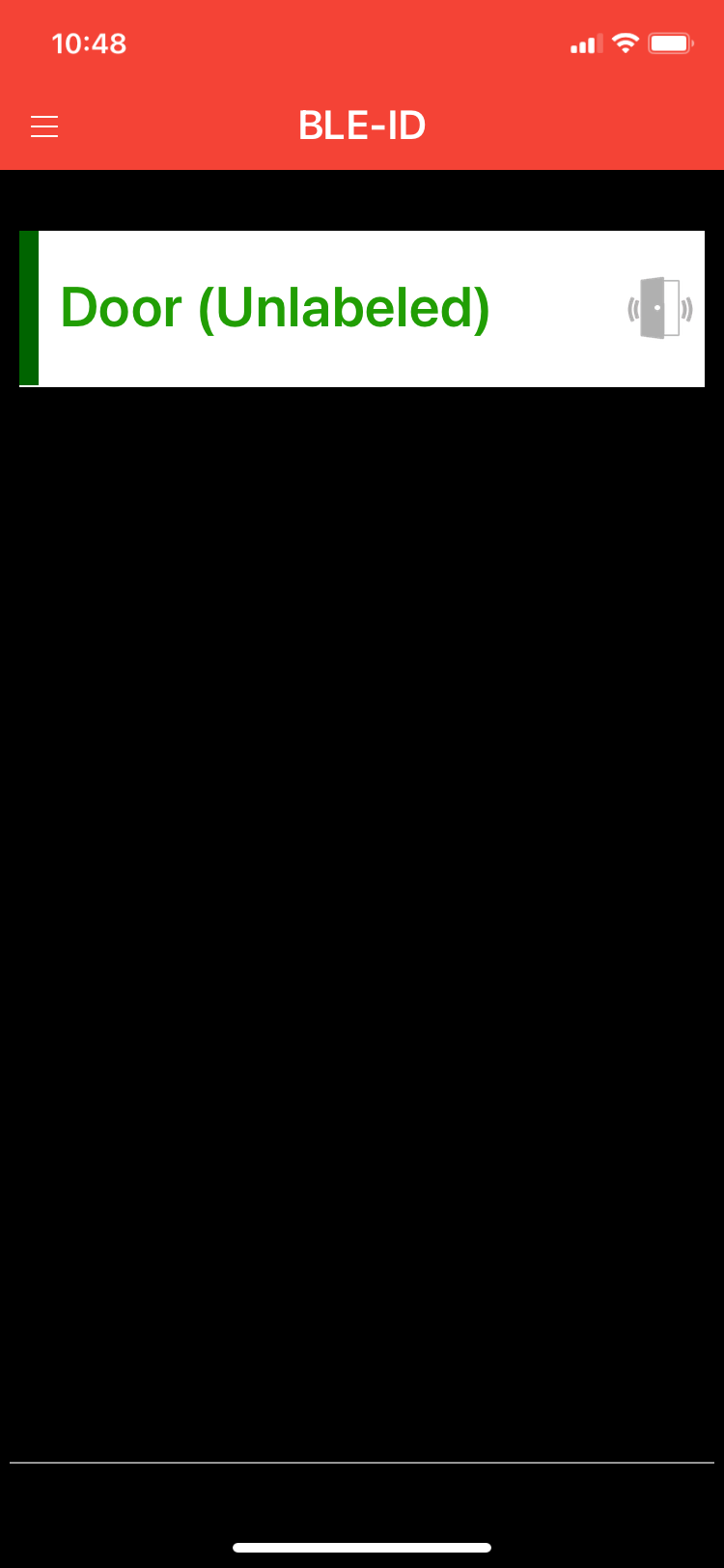

6. Place the iPhone is close proximity to the Door Reader
The BLE ID App should detect the door reader and display it in the available door list
(NOTE: The door name may differ to the name displayed below)
Door Reader Found
Door Reader Found
7. Tap on the Door entry to open the door
This will send your unique ID to the door reader, which will then attempt to authenticate
the passed unique ID, and grant access to the door

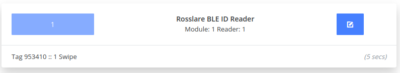

5. The BLE ID app will then send a unique code to the door reader, which will then appear as a card swipe on the Xecure System.
BLE ID App - Card Swipe

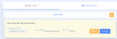

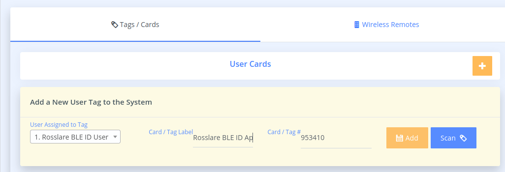

6. This Unique code can then be assigned to an existing User, or a new User, by clicking on the [READ] button when adding a new tag to the system
Adding a New User Tag
